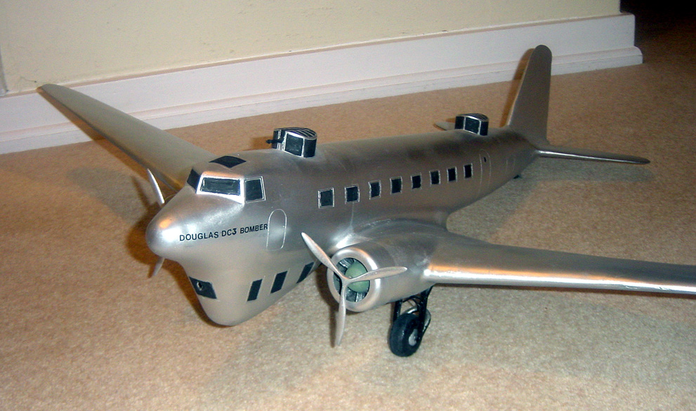

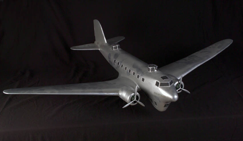

DC-3 Bomber by Fokker
This 1/20 scale trade-show model was a proposal by Fokker, dated about 1935. Fokker was the exclusive European importer for Douglas Aircraft at the time, and this conversion was to make bombers out of existing commercial DC-3 airliners.
In addition to bomb bay doors behind the wing box, the DC-3 bomber featured a couple of machine gun turrets on the roof and a bombardier/gunner blister under the cockpit. DC-3 passenger windows were not covered up, so I assume these aircraft could be un-converted and returned to commercial service, at the end of the conflict.

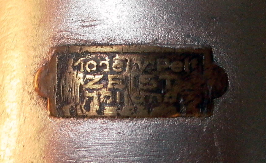

The model is all-metal, with retractable gear, and features the signature plate of J. van Pelt, model maker for Anthony Fokker.
Any references or documentation about this Fokker project would be greatly appreciated. Thank you.

Het model is van metaal, met een intrekbaar landingsgestel en een merkplaatje van J. van Pelt, modelbouwer voor Fokker.

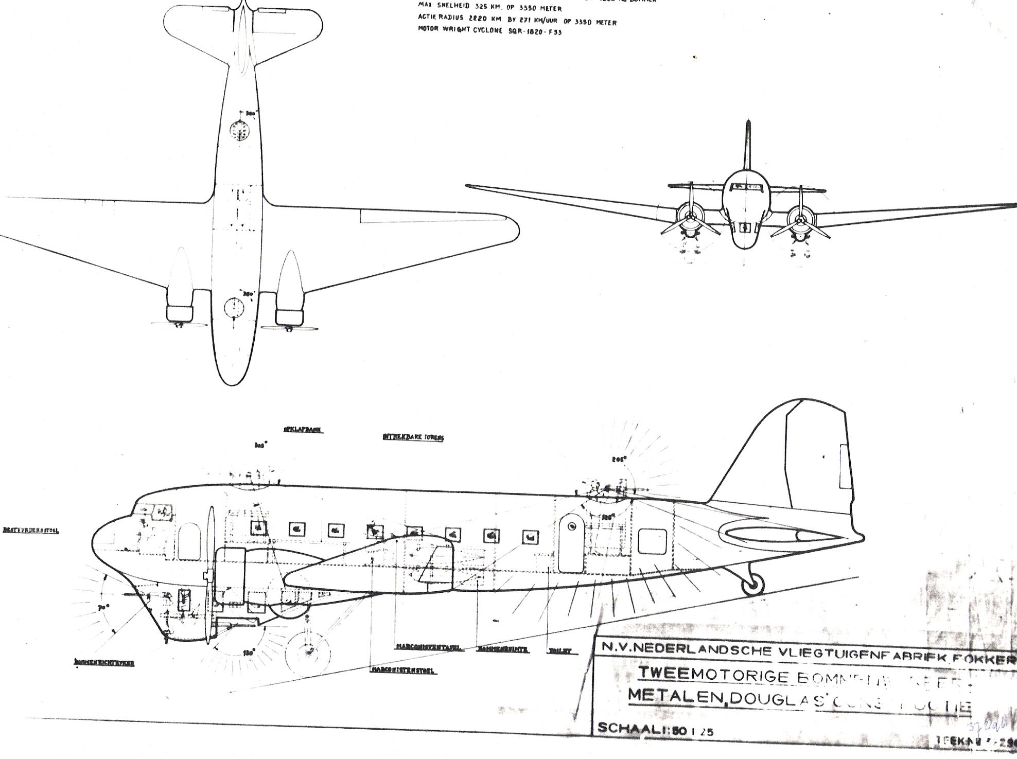

Hei Circle-5,
I found a few drawings from Fokker concern the conversation of DC 2s and DC 3s into bombers. The first drawing is of your model, the bombs were stored horizontal, the other 2 drawings are of a DC 2 conversation. You can see that Fokker studied several ways to carry a bomb-load, internal or external.
Some data about the proposed bomber like your model:
Engines: Wright Cyclone SGR 1820 F53
Max speed: 325 KM/H at 3350 m.
Range: 2220 km by 271 KM/H at 3350 m.
Best regards,

Hi Mathieu,
I am amazed that you found these drawings. This is exactly what I was hoping for! Now we know these were serious proposals, with bombs stored horizontally, and two gun positions in the DC-3 gondola. This is fantastic!
I cannot thank you enough!
John (circle-5)

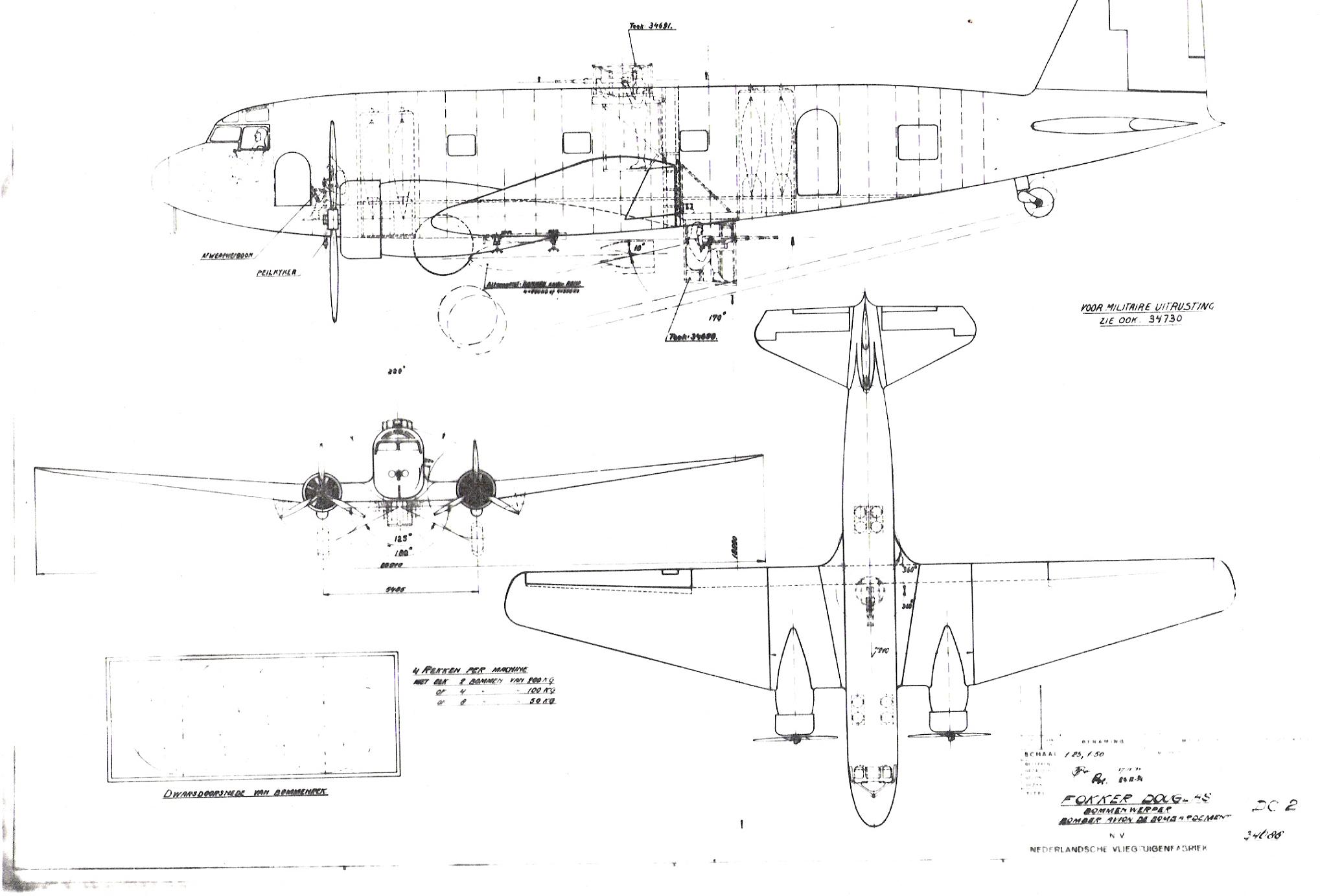

I have another drawing from Fokker of a military DC 2/3, it shows several configurations of how the military DC could be used. These were:
1, transport of aeroengines there could be 4 engines in the fuselage.
2, troop transport, the capacity was 27 completely equipped man and a range of 850 km or 38 man without equipment.
3, transport of wounded people, max 16 people could be carried.
4, fuel transport, with special tanks in the fuselage 3500 liter could be transported.
As we can see a DC with floaters, I assume that this was a proposel to Sweden. I also have seen a list of instruments to be used in this aircraft, if you are interested I can scan the list and post here.

Thank you Mathieu,
This is another great drawing you found there! In fact, the Bombenwerfer variant shows exactly my model, with glazed MG turrets -- does it say 2200 rounds? Is that for each gun or total?
And yes, if you don't mind, I would love to see more information, including the instrumentation. Do any of these documents have legible dates on them?
