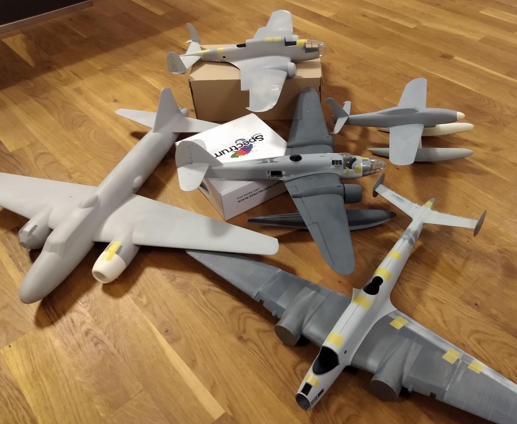

    Well, I guess I have a certain talent for starting new projects. My ability to actually finish anything, however, is still improvable
    Here are some: Betty, Seiran, LeO-45, PZL-37 and Fiat RS.14

    Once a model gets to an more advanced state, I normally split the fuselage into two halves, which than show some recessed lines on the inside where frames can be added later on by hand. The wings also have to be split into several parts, especially because of the wheel well. On the LeO-451 in the picture above, you can see that the wings consist of various smaller parts. From my experience, one of your biggest challenges in 3d-printing is gravity. You cant print in thin air, you always need something to print on. So, overhangs are allways difficult.
    The Betty and Seiran in the picture above are in a very early stage, basically they just consist of a few hollow shells.

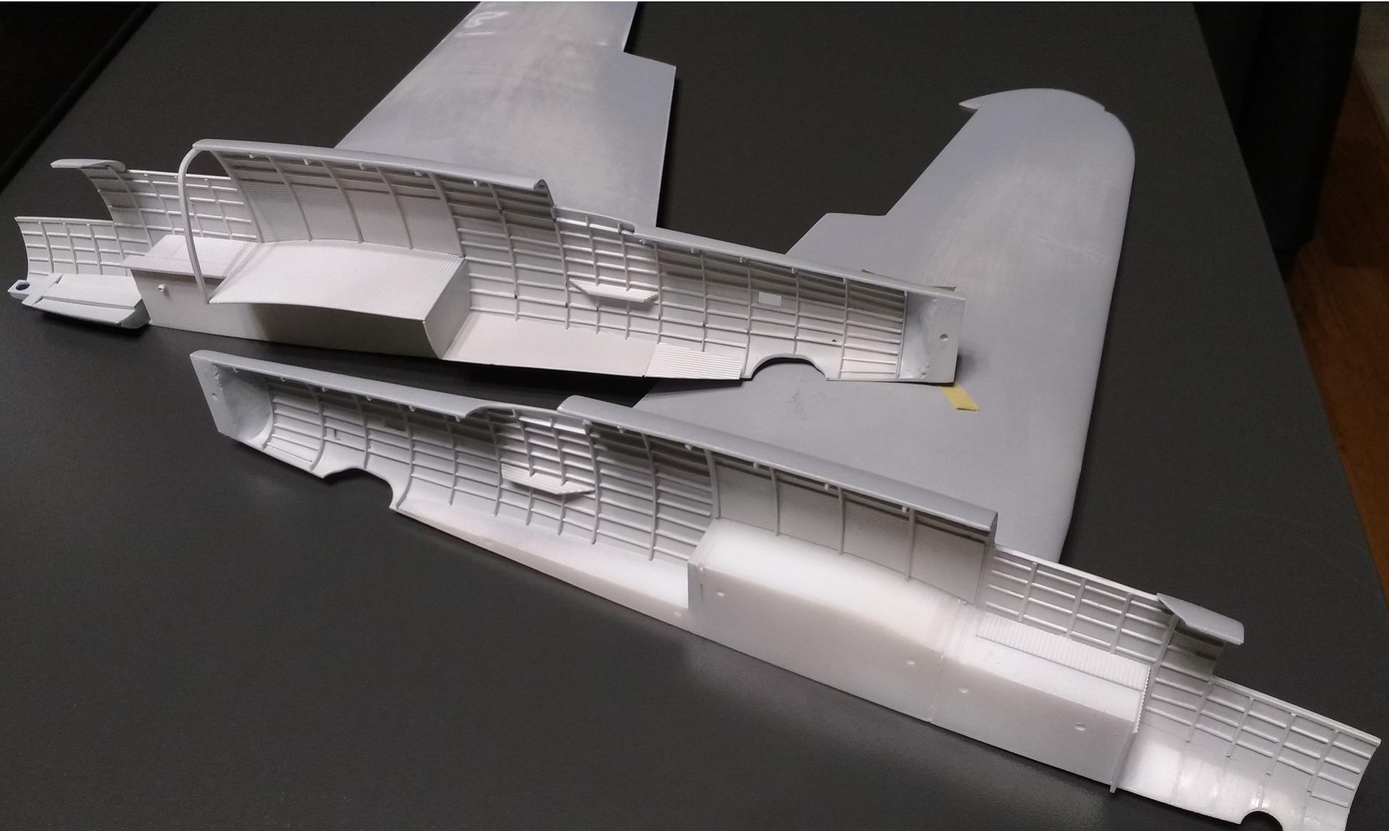

    The PZL.37 is already in a very advanced state. It would jus take a bit more tim to actually finish it. Here, the vertical frames were added later on to recessed lines on the inside of the fuselage. The horizontal stringes were added completely by free hand from Evergreen profiles.

    On the Fokker T.V, my plan is to make the rear fuselage as one part, and the forward fuselage as the halves.That I already did with the first printed "prototype".
    I already thought about making this a small business. I whish I had more time. Due to my regular work, I usually only find enough time for 3d drawing on weekends and days off.
    And then, the printed parts are still miles away from what one could expect from injection modelded kits. A lot of sanding, scribing and scratch-building is necessary to achieve something halfway presentable.
